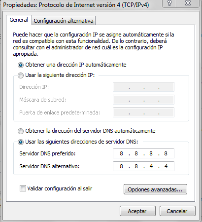

[UPDATE 2]  After seeing the posts about changing the DNS to solve the problem, I thought I would add the following information in case it is relevant:
  • I am using the 64-bit version of Internet Explorer 11, and confirmed that it is operating in 64-bit mode by inspecting the browser's user agent.  You can review your browser's user agent by visiting the site http://user-agent.me/
  • My Internet protocol properties are set to "Obtain DNS server address automatically".  This works with my wireless router, and I have never been tempted to change it.
[UPDATE 3]  After thinking that I was safe, having done multiple successful searches for updates, the 80246002 problem returned on my machine!  I rebooted my wireless router and my machine but it did not help.  So, I went ahead and tried the DNS trick:  I changed the preferred DNS server to 8.8.8.8 and the alternate DNS server to 8.8.4.4, and then rebooted.  Now Windows Update search is successful!  I am humbled, and grateful!
