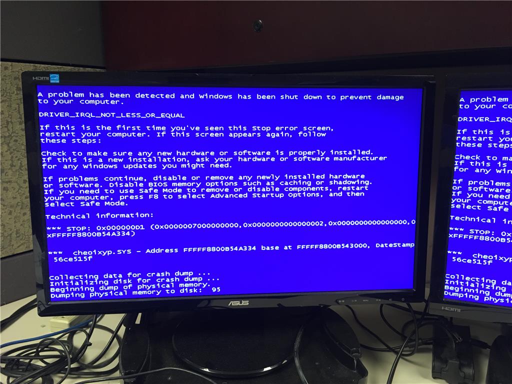

    Good Morning,
    I am having a similar issue with my company laptop.  Below is a photo of the blue screen:
    I was unable to attach the dump file to this message but can get it to you if necessary.  I am running Windows 7, Office 365, and my company IT has McAffee (See below for details).
