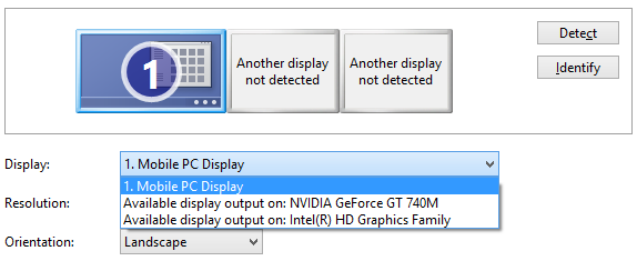

I recently purchased a new laptop with Windows 8, which I had never tried before (so I am new to this). I updated to 8.1 the other day, and afterwards I tried connecting the laptop to a brand new LG HD TV through the HDMI ports. I opened the "Project" menu and selected "Duplicate", and while I see something change on my laptop screen (it flickers, and the resolution/colours change), the TV picks up no signal.
The HDMI port on the TV is working correctly (tried it with another device), and so is the HDMI cable. There is some sort of connection happening because the TV enables the HDMI input only when something is detected on the other side of the cable.
I have seen that it might be a known issue with Windows 8.1, but I can't find a solution anywhere. My laptop has an integrated Intel GPU as well as an nVidia GeForce 740M, and I thought perhaps the problem was that it uses the Intel card as a standard, only switching to the nVidia when necessary, but the HDMI is "controlled" by the nVidia. So I've tried disabling the integrated GPU (to no avail - it just switches to the Microsoft Basic one rather than to the better card - this has been checked through dxdiag), as well as uninstalling and reinstalling the nVidia drivers (which were up to date to begin with). I have checked the BIOS to see if I could change the priorities, but there was no option like I see on my Windows 7 desktop.

Did the system restore, it did the trick. This is with a Windows 8.1 computer. I can't find the specific upgrade that did this, but it was an automatic upgrade I did on september 9. There was nothing else done this day. other than "Windows Update", so that IS the problem. I hope this helps anyone!
