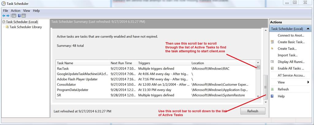

What has happened is that your antivirus or antimalware software has properly identified client.exe as an unwanted program and removed it.  When this happens, however, there are often remnants of the malware left behind that attempt to start the now-missing malware executable.
In your case, it seems that there is a scheduled task that is attempting to start client.exe.
  • Click the Start Orb, type the following into the Search box and press Enter
    Task Scheduler
  • When the Task Scheduler window opens, click on "Task Scheduler (local)" in the left pane
  • Use the scroll bar at the right to scroll down to "Active Tasks"
  • Use the inner scroll bar to scroll through the list of Active Tasks to find the one that is attempting to start Client.exe.  Look for "C:\Program Files (x86)\Search Extensions in the "Location" field
  • When you find the entry that has Search Extensions in the Location field, double click it.
  • In the right pane ("Actions") find "Delete" near the bottom of the list and click it.
  • Close the Task Scheduler and reboot
  • You shouldn't get the popup any more
        Task Scheduler
