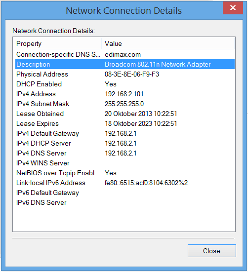

    From the ping I received: bytes=32 time<1ms TTL=255
    I stil can't connect but thankyou anyway
    2013-10-20T04:57:11+00:00
    So what i can confirm is your ip configurations are ok.. So u need to go ahead with adsl /dsl connectivity issues.. May be u need to contact isp ..

    I am facing similar issue. It's not the ISP's problem. My internet connection is working fine on another laptop. Have tried manually configuring the address as well as keeping it automatic. Have same Broadcom network adapter.
    Awaiting further inputs....

    can u ping 8.8.8.8 ?
