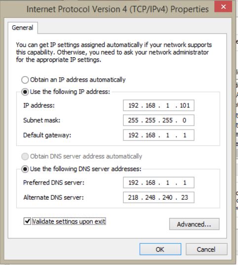

    I am facing similar issue. It's not the ISP's problem. My internet connection is working fine on another laptop. Have tried manually configuring the address as well as keeping it automatic. Have same Broadcom network adapter.
    Awaiting further inputs....
