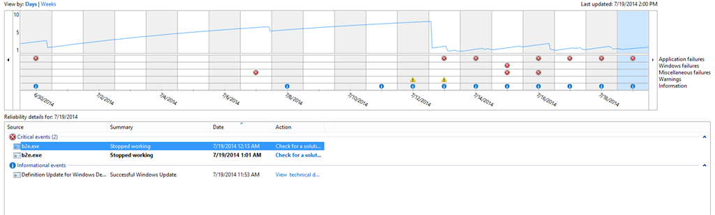

    Here is the reliability history:

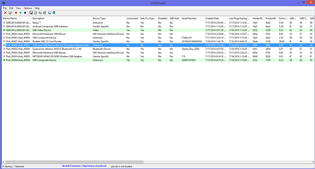

    And yes I did use that tool. Here is what I see:

    Does it make any difference to your problem if you uninstall (via Deview) the device that you have highlighted?

    Does the USB program you have contain the ability to monitor USB traffic?
    This may be usefull, http://msdn.microsoft.com/en-us/library/windows/hardware/hh451296(v=vs.85).aspx If you can watch the data from that port you can see what it does and doesn't do.

    I looked at the WU and CBS logs haven't found anything exciting. When did you fix the task scheduler? It looks like it went out on 7/13/2014 because there was a huge spike in Windows Update Errors. It looks like it couldn't figure out if it was allowed to do an update while on battery power had issues with an internet connection and it paused on 28 updates that ended up failing because it couldn't set a property.
    What is SWUpdate? Is that a Samsung updater? It looks like something is manually trying to update but the items being updated don't need it. The last ones I say were You may want to disable it to see if things improve on your computer. There is a good chance that it keeps updating things with drivers that don't work. Windows update doesn't always download the newest driver because it only uses ones that are best for you computer. So if knows of an issue or isn't sure it will work then it will reject it
