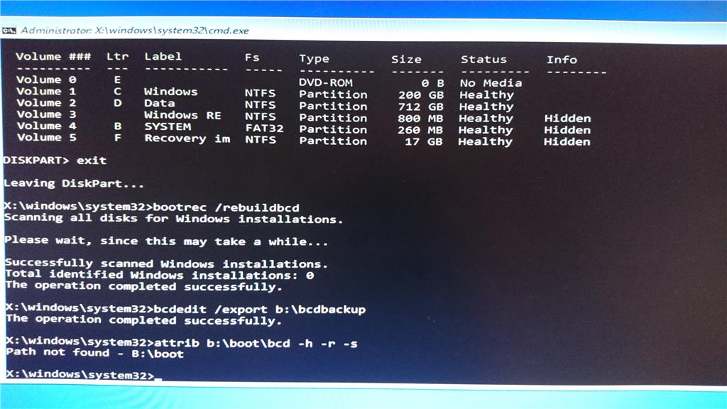

    2017-10-13T13:26:20+00:00
    Hi Greg,
    Found the SYSTEM partition on volume 4 and assigned it letter B, unfortunately still getting "Path not found - B:\boot" error when trying to alter attributes (point 5), could the boot file be somewhere else?
  3. Greg Carmack 24,780 Reputation points Volunteer Moderator
    2017-10-03T04:26:08+00:00
    Everything is here for doing the gold standard Clean Install Windows 10 including how to prepare, back up, illustrated install steps for how to delete all partitions down to Unallocated Space to get it cleanest, then setup it up optimally so that it won't have any issues at all.
    I wrote earlier in this thread about how to determine which is the System partition since C is not always the correct letter in boot mode:
    From Command Line type:
    DISKPART
    LIST DISK
    SEL DIS # (replace # with WIndows disk)
    LIST VOLUME
    Now determine which volume has the boot files, which is normally the System Reserved or EFI System partition preceding C Windows drive.  It may be labeled System which is how you'd know for sure.  If there's no drive letter then SELECT VOL # with the number and ASSIGN to get a letter to use temporarily.
    I hope this helps.  Feel free to ask back any questions and let us know how it goes.  I'll keep working with you until this is resolved.
