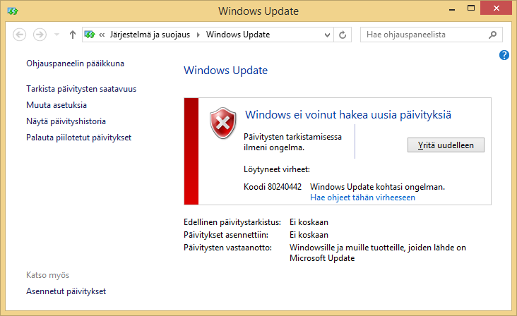

    I'm not sure why you wanted a screenshot; It doesn't provide any additional information. I suspect you won't be able to read Finnish.
    2014-05-06T13:33:54+00:00
    Hi Mika,
    Sorry to hear it didn't work.
    Could you please post a screenshot of the error? To do that, hit the Windows key to take you to the Metro Start screen with the tiles and then start typing the word "Snipping". Before you've finished, you should see "Snipping Tool" appear on the right. Click that to open it and and click "New". The screen will turn light grey when you do that.
    Use the mouse to draw a rectangle around the error to include the title bar and any other infomation and then click "File" followed by "Save As", You can give it a name if you like or just leave it as "Capture.PNG".
    Then come back here, click the second button from the right which says "Insert image" if you hover the mouse over it. Here's a screenshot of it to illustrate what I mean.
    In the next menu which appears, click the "Browse" button and then navigate to the screenshot you just created. Then click the "Upload" button to paste it into your next post.
