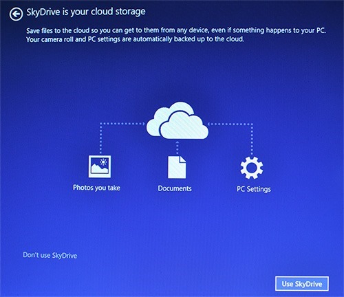

    Dear SMHOGAN,
    Do the system refresh without deleting your files.
    You will be asked to setup Skydrive (Onedrive) as your default backup location and/or cloud storage.
    Decline this option: don't use Onedrive (see pic). After that, it must be fine. Really. It must be :-)
