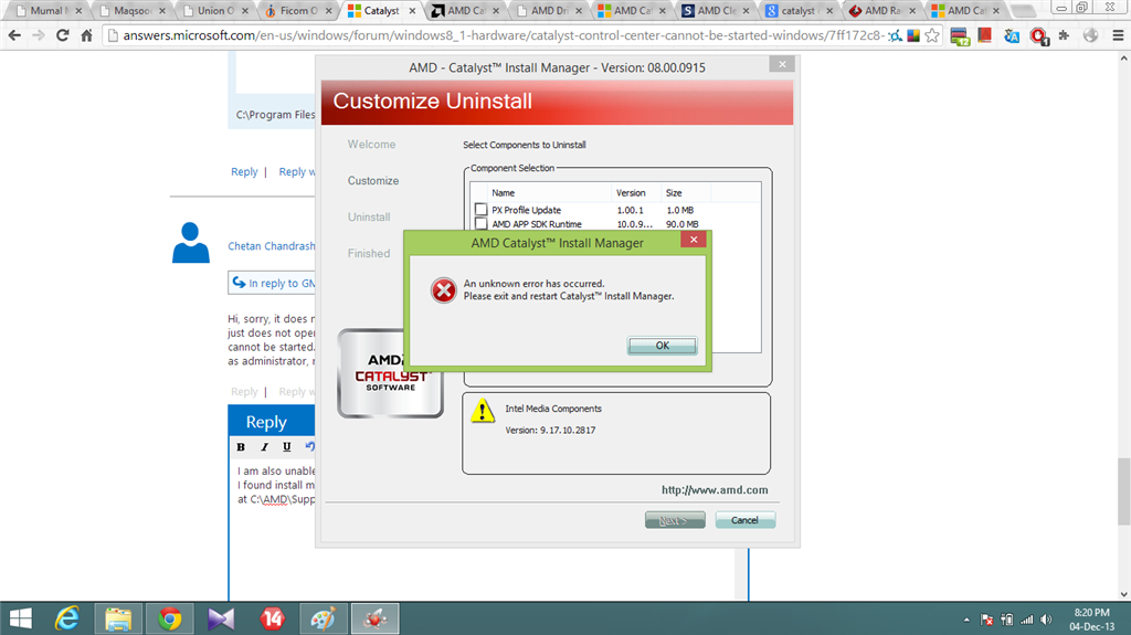

    I am also unable to uninstall.
    I found install manager (and setup, both of open the same install wizard type thing) at C:\AMD\Support\13-9_win7_win8_32_dd_ccc_whql\Bin\
    First it says "unable to load detection driver" and then:
