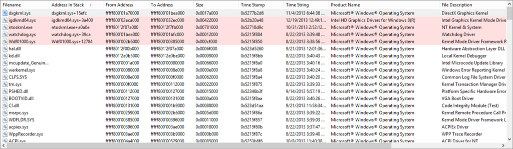

    i am getting BSOD now when i put the laptop on sleep.. the error is
    VIDEO_DXGKRNL_FATAL ERROR
    i have run blue screen viewer and here is the image is this related to the graphics driver problem?
