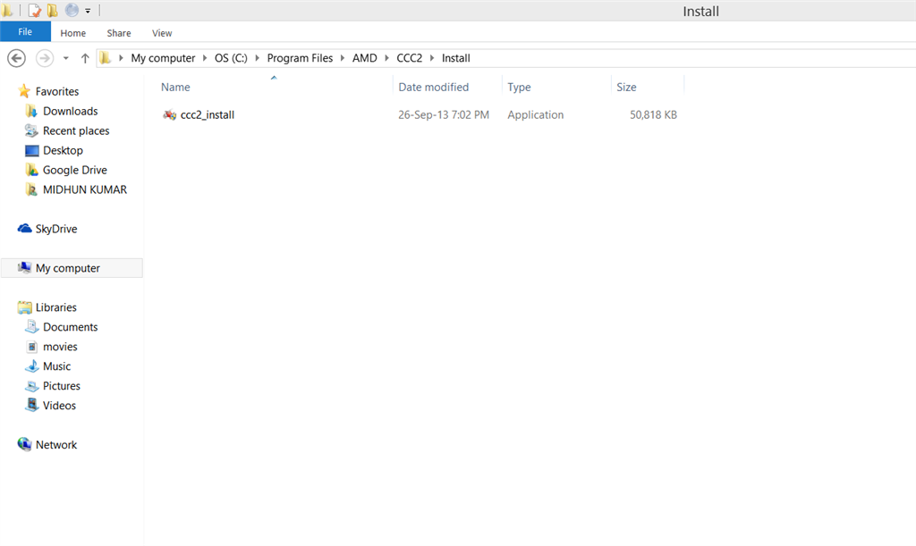

i am also using inspiron 7520
after updating to 8.1 my amd catalyst control centre stopped wrkng
finally i got it resolved after installing "ccc2_install" in the folder path given below
C:\Program Files\AMD\CCC2\Install

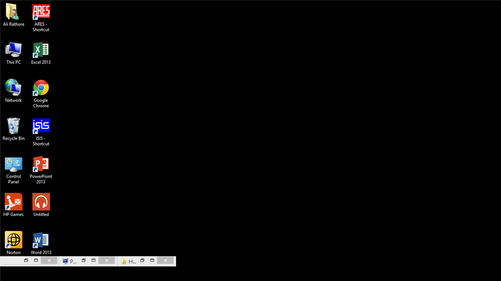

    I did the same thing but as soon as it installed, my background went black, my start toolbar vanished, can't seem to find the shutdown button. The windows button on my keyboard isn;t working. Please help!
