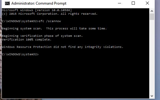

    The additional xHDD confirms that it is not the xHDD at fault but the laptop.
    Windows cannot make system images onto USB sticks but only onto external disks.  So that is not a fault.
    [The additional xHDD will not be wasted but we can get onto that topic later]
    I do not think that SFC will achieve anything.
    I think your startup errors should be asked in another separate question.  I do not expect to be any help on that but I will watch the thread to see what is going on.  Before you post, search the forum for C++ startup errors to see if there is any existing guidance on the subject [it does ring a vague bell].
    Running ChkDsk again would not help with the C++ startup issue.

    2016-08-04T19:31:16+00:00
    Here is the screen sot of the SFC scan ![](https://learn-attachment.microsoft.com/api/attachments/650f8ab7-28ec-4efd-bbc1-29394c41a05f?platform=QnA)
    So now know the error exist on 2 xhdd  and will not read a flash drive...So what next ??
    By the way I did check the same version appeared on both Pc's.
