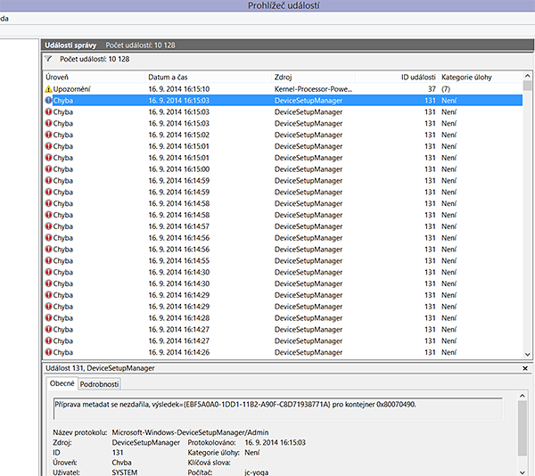

Since September 12, 2014 I receive multple errors in Event Viewer from DeviceSetupManager.
Sample error looks like this:
Metadata staging failed, result={E9031C57-C25D-8227-E390-3662BD05D0CB} for container '0x80070490'
This error occurs when the Metadata Refresh in \Microsoft\Windows\Device Setup scheduled task is run or when accessing Control Panel -> Devices and Printers when Device Installation Settings are set to "Recommended" or are set to "Automatically get the device app and info provided by your device manufacturer".
What I believe happens is Windows attempts to contact a Microsoft web server to obtain additional information about a device (custom icon for example) and this process had started to fail for me since September 12, 2014. More details on it can be found on this page.
Looking at the Debug logs of Microsoft-Windows-DeviceSetupManager I can see the following error:
Job (13) has completed for device container '{3c7878f1-bc70-523d-b17c-7aaf5253f81a}', status=Hard Error
Looking at the network traffic, I can see communication using HTTP protocol with Microsoft server which returns HTTP 301 (page has been moved).
SFC /scannow returns no errors. All the latest Windows Updates are installed. I've already tried to remove %PROGRAMDATA%\Microsoft\Windows\DeviceMetadataCache folder to no avail.
Does anybody else see this error message and what can I do to fix the problem?

    2014-09-16T01:03:30+00:00
    I wish Microsoft would fix the Error.  I don't like changing anything in the registry.

    2014-09-16T14:26:03+00:00
    similar here
    2014-09-16T18:40:25+00:00
    My main concern is I'm not able to figure out if this problem actually affects and undermines the way devices get installed/updated. Needing to restore this system, I would like everything to work properly. Were I sure all is fine apart from those event viewer error messages, I could live with them for some time, while waiting for a fix
