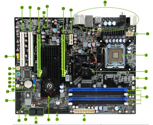

    About the only things I can think of now are:
    1. The card wasn't re-seated properly in the slot.  Make sure it's pushed down all the way.  Or take it out and carefully put it back in, making sure everything is lined up properly.
    2. The card is defective.
    3. The PCI slot has a problem.  If the second PCI slot (the other white connector) is empty, you can try moving it there.
    This wireless adapter should be in one of the two white connectors at the upper left of this figure:

    If re-seating the card or moving it to the other PCI slot doesn't solve it, I'm afraid you'll have to take the computer to a local repair shop for some hands-on diagnosing. If you do, I suggest not going to a chain store but to an independent shop -- ask your friends with computers for recommendations.
    Alternately, you can buy a new wireless adapter.  You can get a USB adapter (which won't require you to open the case to install it) or you can buy a new internal adapter.  These days, you'll be more likely to find a PCIe card than a PCI card such as the one you have now.  Your motherboard has both PCI and PCIe connectors:  the PCI slots are white and the PCIe slots are green.
