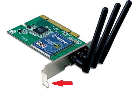

Actually, the Quick Installation Guide wants you to install the driver BEFORE the device is physically installed in the computer. So, turn the power off, touch the case with your hand to discharge any static electricity, and carefully remove the card. There probably will be one screw holding the card in (if the screw is present, it will be in the slot at the top of the bracket -- see arrow):
Then gently but firmly pull the card up. It probably will be easier to remove if you unscrew the 3 antennas. You may have to pull one end of the card up first; just don't rock the card side-to-side.
Once the card is out of the computer, you should be able to more easily see if you have version 2 or version 3. And, while the card is out and you have more room, do yourself and your computer a favor: buy a can of compressed air and blow out all the dust.
