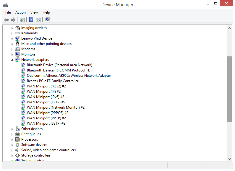

You will need to activate the wireless card from the control panel--Device manager--network adapter--right click your modem--properties--power management--uncheck allow the computer to turn off this device to save power.
This is not listed by microsoft in any troubleshooting wich is so bad that it couldnt find a solution to a problem.

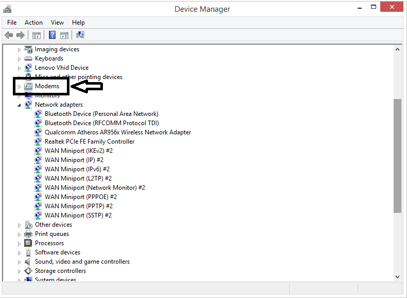

    Thank you for visiting Microsoft Community.
    You need to right click on the mentioned highlighted part and follow the further steps. Do get back to us after trying those steps. If issue will persist we will be more than happy to assist you.
