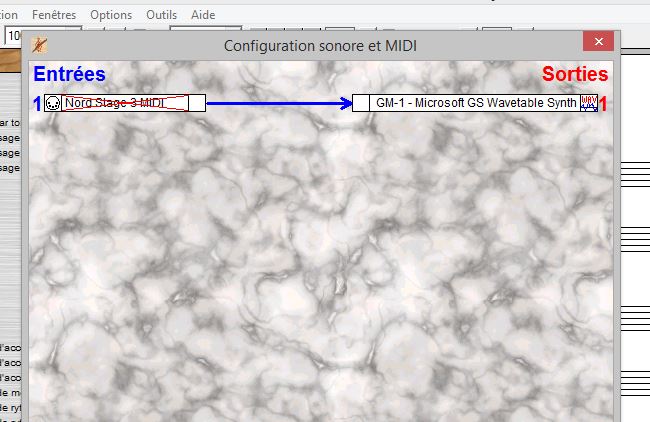

    Keyboard Clavia Nord Stage 3
    Computer : Lenovo S20 Touch with Windows 8.1
    Softwares : Cubase, Sonar, Pizzicato.
    Connection : USB <------> USB
    The Nord Stage is recognized but... with a red cross and...
    Same issue than donmeczblast      UNACCEPTABLE !!!!!!!!!!
    PLEASE, can you propose the good driver to resolve this bad issue !!!!!!!!
