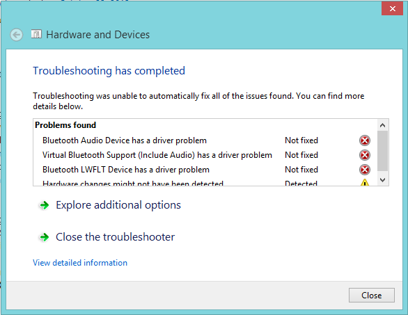

    I am using Lenovo G500 64-bit machine with built in windows 8. Bluetooth was working fine before but after I upgraded to 8.1 bluetooth has stopped working. I tried both of your methods and ended up with something like this:
    Now I am unable to connect my headset through bluetooth :(

    Hey man,
    No guarantees, but someone with an ASUS machine used the same driver and said that it worked.  Check the first page of the tread and look for:  GuylaineGuimond replied on  January 23, 2014
    As long as your hardware is form Qualcomm Atheros Communications, that driver should work fine.
    Good luck!
