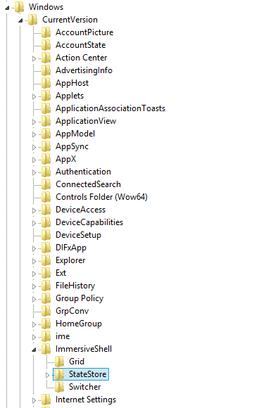

 My friend this is a Windows 8.1 Update 1 bug. Try this steps:
step 1. HKEY_CURRENT_USER\Software\Microsoft\Windows\CurrentVersion\ImmersiveShell\EdgeUI
step 2. Set both DisableTLCorner and DisableTRCorner to the data value of 0
step 3. exit and Restart computer
Try this steps and everything is ok :)
