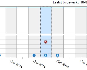

    Hey guys,
    Just wanted to report here that I got a LiveKernelEvent hadware error after installing the Tuesday updates but luckily no BSOD. Looking at the time of the error, it appears that it occurred seconds after booting up my PC. The weird thing is that the PC didn't act strange or freeze up. Also, googling this error shows that it's mainly associated with BSOD's while my PC didn't give any.
    I couldn't find any errors about it in the logs but there is only an information log about it (Dutch):
    Foutbucket , type 0 Naam van gebeurtenis: LiveKernelEvent (name of event)
    Antwoord: Niet beschikbaar
    Id van CAB-bestand: 0
    Handtekening van probleem (signature of problem): P1: ab
    P2: 1
    P3: 1130
    P4: 0
    P5: 2
    P6: 6_3_9600
    P7: 0_0
    P8: 256_1
    P9:
    P10:
    Toegevoegde bestanden (added files):C:\Windows\LiveKernelReports\win32k.sys\win32k.sys-20140814-0416.dmpC:\Users\John\AppData\Local\Temp\WER-75054875-0.sysdata.xmlC:\Windows\LiveKernelReports\win32k.sys-20140814-0416.dmpC:\Users\John\AppData\Local\Temp\WER5226.tmp.WERInternalMetadata.xmlDeze bestanden zijn mogelijk hier beschikbaar: C:\ProgramData\Microsoft\Windows\WER\ReportQueue\Kernel_ab_94cacb2ac179ec1a05f1eecf223eba230c735ac_0  0000000_cab_16095235
    Analysesymbool: Opnieuw zoeken naar oplossing: 0Rapport-id: ce18eb3c-23bb-11e4-be7d-bc5ff44ab185Rapportstatus: Bucket-id: LKD_0xAB
    I could only find 2 files that were given by the error log. There are no minidumps in C:/windows while it is enabled in the options to register any.
    Also looking at the Performance and Reliability graph I could see the error but the graph line didn't fall so I'm not sure if there's really an occurred error here.
    I'm not sure if I should be concerned about it or not if it didn't give me any BSOD.
