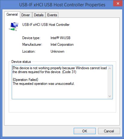

    Hi Rajith,
    When I start the laptop it shows "THREAD_STUCK_IN_DEVICE_DRIVER" error and reboots , then starts normally.. And on updates it says, there are not any important Update...! as the solution provided by you, I have a yellow flag on "Intel WiUSB - USB-IF x HCI USB HOST Controller", and on that when i hit update, it says 'It is up to date'..
    Mine is a Dell Lap which i had bought last December.
    Below is my Device manager screenshot:
    Provide me a solution on this...!
