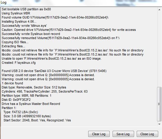

    I have never needed to look at the Rufus log since it works every time for me and everybody else but mine looks a lot different (better) than yours.
    You start getting errors after Extracting files  and I don't know what that means.  Are you just using the Rufus defaults?
    Maybe the problem is with your Windows 7 machine (just a thought) or maybe your thumb drive.  I have never seen anybody have all these problems :-)
    Mine looks like this:
    Copying ISO files...
    Extracting files...
    libcdio: Found Extension: Joliet Level 3
    Disc image is an ISO9660 image
    This image will be extracted using Joliet extensions (if present)
    Extracting: F:\HBCD\Boot\Keyboard.bat (1.1 KB)
    Extracting: F:\HBCD\Boot\SeagatDW (1.1 MB)
    (...lots more until it is finished...)

    mmm. I don't have a network cable plugged in, this message came up before the mini xp choice it was just a quick flash on the screen  I can't use F2 to get to the bios. Just want to make sure that hirens, wont change my usb so that I can't put my files on it, you have never seen the pop up when using the, rufus that all files will be destroyed? Got an error trying to use USB to make iso.
