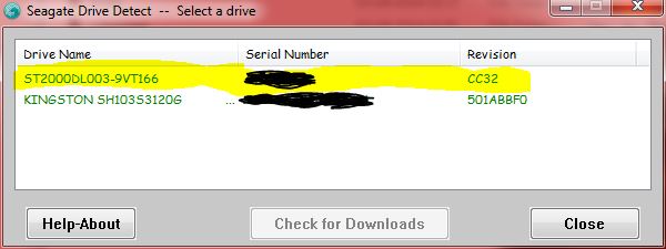

    As you say your Model ST2000DL003-9VT166 ATA Device is not an external USB drive. The Seagate link I provided contained CC32 firmware for the drive. Are you saying that you already have CC32 installed?
    http://knowledge.seagate.com/articles/en_US/FAQ/218171en
    2014-08-05T00:40:50+00:00
    Seagate Drive Detect software says I have the newest firmware version:
