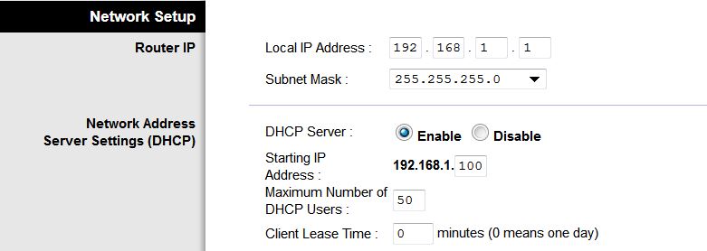

    I think I have done it correctly. My router is a Netgear WNDR3800. Does this look right?
    My printer is an Epson Workforce 645. I couldn't figure out how to manually assign the IP address in the printer itself but it is currently using that IP (192.168.1.4). Will this be fine for when the printer needs to reconnect?

    Yes, that looks right.
    Your router defaults to permitting the DHCP server to use any IP address in the subnet, but the router also has the ability to "reserve" an IP address so that it isn't one of the addresses that might be automatically allocated.
    You have "reserved" 192.168.1.4 for your Epson 645 -- and that is the same address currently being used by the printer ... so if the printer works now, it shouldn't have any problems reconnecting.

    If your printer is already configured and working properly, it's actually a bit simpler to configure the router to "reserve" the IP address that is already assigned to the printer.  That way, you won't have to uninstall and reinstall the printer.  This has the same effect as using a static IP address:  the printer always has the same IP address, so the printer and scanning software in Windows will always be able to find the device where it expects it to be.
    A. Print a network status sheet to determine the printer's network settings  (manual, p. 31:  https://files.support.epson.com/docid/cpd3/cpd38706.pdf)
    1. Press the home button, if necessary.
    2. Press the arrow buttons to select Wi-Fi Setup and press the OK button.
    3. Press the arrow buttons to select Print Status Sheet and press the OK button.
    4. Press the start button to print the network status sheet.
    Note the following items from the network status sheet:
    • Printer's IP address (this will be of the form 192.168.0.x)
    • Printer's hardware address or MAC address (this is 12 hexadecimal characters; it may be displayed with colons or dashes between every two characters -- 00:00:00:00:00:00 -- or as one string; upper/lower case can be ignored)
    • There also may be an entry for "host name" or "printer name" or something similar; I don't have any Epson devices, so I can't be specific here
    B.  Reserve the printer's IP address (manual: ftp://ftp2.dlink.com/PRODUCTS/DIR-655/REVA/DIR-655_REVA_MANUAL_2.30_EN.PDF)
    1. Open a web browser, enter the following in the address bar, and press Enter
         192.168.0.1
    (you also could enter http://dlinkrouter) 2. Select Admin from the dropdown menu and enter the password you created for your router; if you didn't create a password, leave the password field blank, which is the default 3. The User Guide for the DIR-655 that I found isn't clear on how to navigate through the web configuration utility, but you want to find the section for "Network settings" (manual p. 36) and then the subsection for "DHCP Reservation" (manual p. 38) 4. On the DHCP Reservation page: - Click the "Enable" box to check it - Use the dropdown box to see if your printer is listed; if so, click the left arrows; if not, enter the host name or printer name from the printer's network status sheet; if the printer is not in the dropdown list and the status sheet didn't have a printer name, use something that makes sense, such as EpsonXP310 - Enter the printer's IP address from the printer's network status sheet - Enter the printer's MAC address from the printer's network status sheet - Click the "Save" button (do NOT click the the button to "Copy your PC's MAC address") 5. Exit from the router's configuration utility (i.e., close the web page and/or the web browser)
