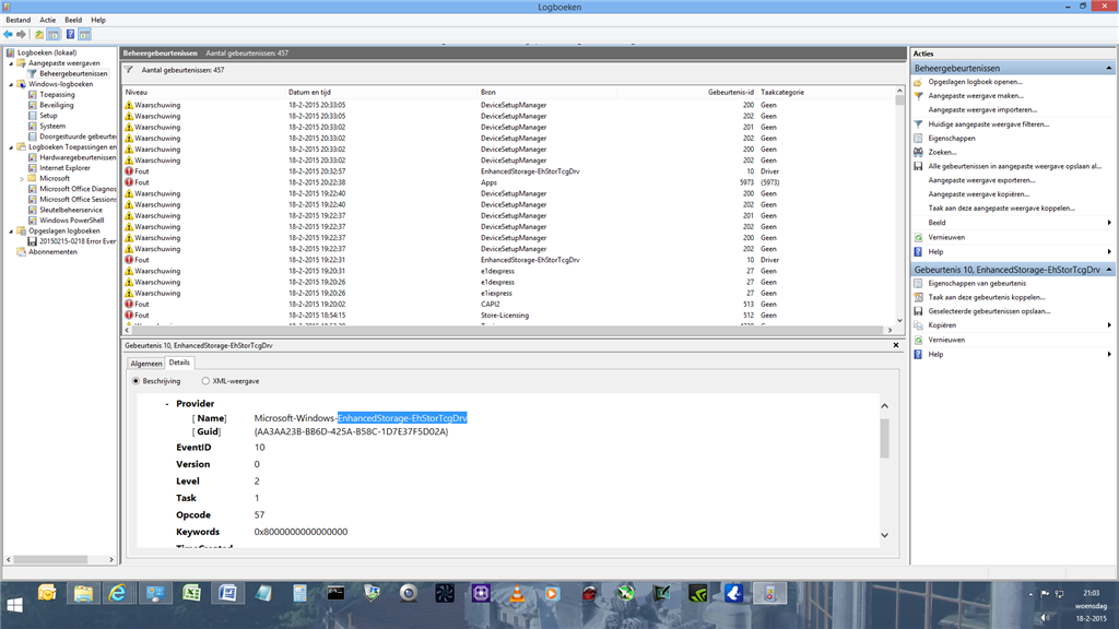

    2015-02-18T20:11:25+00:00
    Dear all,
    I have been reading this post since my system too suffers from this error, only at boot/reboot. It may or may not affect the rest of the system, fact is that even a simple internet game on a website leads to first loosing audio and later a crash of IE. Probably these problems have to do with other underlying issues, of which there seem to be many.
    But coming back to the 'A TCG Command has returned an error' (EnhancedStorage-EhStorTcgDrv), it seems that this is something that is not well-known yet, and Microsoft does not seem to have a clearcut solution for it (yet).
    My system, built and first startup and install on 15 Feb 2015:
    Case: Cooler Master Silencio 550
    Motherboard: Gigabyte G1 Sniper B5-CF
    Bios: F8 (Jul 2014)
    Chipset: Intel Core i5 4590
    Chip cooler: Cooler Master Hyper T4
    Graphics Card: MSI NVIDIA GeForce GTX 970
    Memory: Crucial DDR 3 Ballistix 4GB 2x
    Power: Seasonic S12G PSU 450W
    SSD: Crucial SSD MX100 256GB
    HDD: Seagate ST2000DM001
    OS: Windows 8.1 Professional x64 OEM
    Monitor: iiyama ProLite E2208HDS
    First problem:
    A TCG Command has returned an error. Error happens at every startup/boot of system.
    Ran sfc, no problem
    Ran chkdsk, no problem
    As can be seen, two startups (19:22 and 20:33) both lead to the TCG Command error. Same for earlier boots/startups, it's even the first error in the list from the very first boot.
    Hopefully this issue will be solved in due time.
