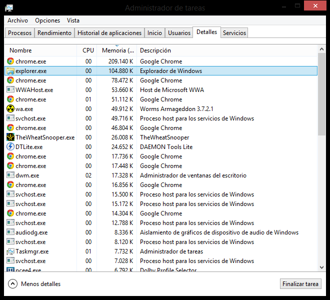

When the game (eg: Battlefield 4) opens, the memory consumption begins to rise, and rise, and rise, non stop, until the system doesn't have more memory available and triggers the low memory warning. However, in the exact moment that I "alt+tab" out of game OR the memory warning does it for me, all of the occupied memory is emptied instantly, like magic!
I was able to "understand" this using Process Explorer by MS (sysinternals), heres a screenshot that shows the "climbing" and the sudden drops:
http://prntscr.com/2809xc
I cant really discover where all this memory is being allocated/used, and I have no idea on whats causing this. I also don't know if this is Windows-related, device-related or driver-related.

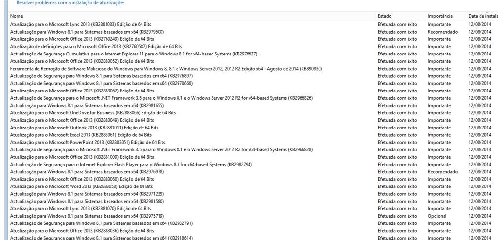

[UPDATE AUGUST 14th 2014]
The problem has been finally fixed by Microsoft with the release of the August updates on Aug. 12th.
Make sure to install every single update available - including the optional ones - and you'll no longer receive low-memory warnings when running fullscreen games/apps with different resolution/refresh rate.
Also make sure you're using the latest drivers available for your Intel and/or Nvidia GPU (it might be important).
Windows for home | Previous Windows versions | Gaming
2014-08-13T05:04:19+00:00
I might be a bit cynical but I looked through all the support KB's from the updates today and couldn't find anything that related to fixing this issue (unless I'm missing something)...
Yesterday i have made the update and i found via the link also no description, but...
Yah!, after nearly 10 months, microsoft have now solved this bug.
With the latest patches (Patch Day 12.08.2014, also install the optional Updates),
all different resolutions and framerates works well.
