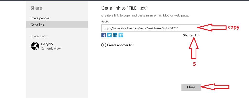

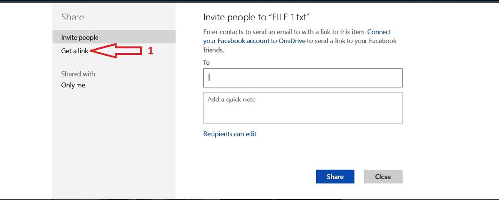

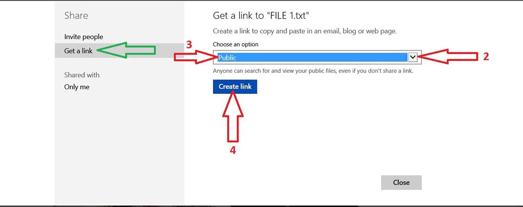

    Try to use a web-browser     http:// onedrive.com
    Sign in.
    1. Pick the file or folder you want to share by
    selecting the check box in the upper-right corner of the item. You can
    also pick multiple items to share them together. 2. Tap or click Share on the bar at the top of the page, and then choose a share option:
    Choose the type of link you want. The permissions for the item are automatically updated when  you create the link.
    View only
    When you share items with this type of link,
    people can view your items without signing in. They can also forward the
    link to other people.
    Public
    A public link is like a View only link, but it
    also allows anyone to find the shared item by searching. If you choose
    this option, people will be able to access the item you're sharing even
    if you don't publish the link you get.
    You can also share files and folders in OneDrive from File Explorer. Press and hold or right-click the file or folder you want to share, tap or click Share with, and then choose OneDrive. This takes you to the OneDrive.
    2014-05-27T07:40:33+00:00
    Hi
    Thanks for your patience with me. I have followed your latest instructions and hope you can now access the CBS log file.
