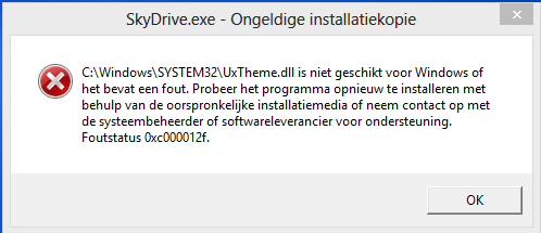

    I have the same problem on a Windows 8 PC (Dutch installation).
    Error message looks like this:
    I uninstalled already Adobe Reader, Java 1.7, Intel Rapid Storage, all the programs that gave this error message. Now even starting SkyDrive.exe from the tiles Start screen of Windows 8 gives this message.
    At the moment the messages have stopped displaying at startup, but when I try to reinstall Adobe Reader, same messages popping up again.
    Problem is I don't have KB2879017 update installed; 18 updates were installed today April 17, but not this one.
    Any clue?
    2014-04-17T16:39:08+00:00
    As I mentioned update KB2879017 is not on this PC.
    So instructions by HartleySpurlock do not apply (refer to his reply on October 15, 2013)
    "Uninstall KB2879017 update. Cumulative Security Update for IE 10 for Windows 8 x64 systems."... etc.
    But one of the updates today was KB2936068 - another Cumulative Security Update for IE 10 for Windows 8 x64 systems.
    I tried my luck and uninstalled KB2936068 , and after restart I marked the update as hidden within Windows Update (so it will not update again, further to HartleySpurlocks instructions).
    And guess what! It did the trick; - no more error messages, and Adobe Reader installed successfully.
    So in my case I solved the problem following HartleySpurlocks instructions (refer to his reply on October 15, 2013) - only I substituted KB2879017 from his instructions by KB2936068.
    Case closed.
