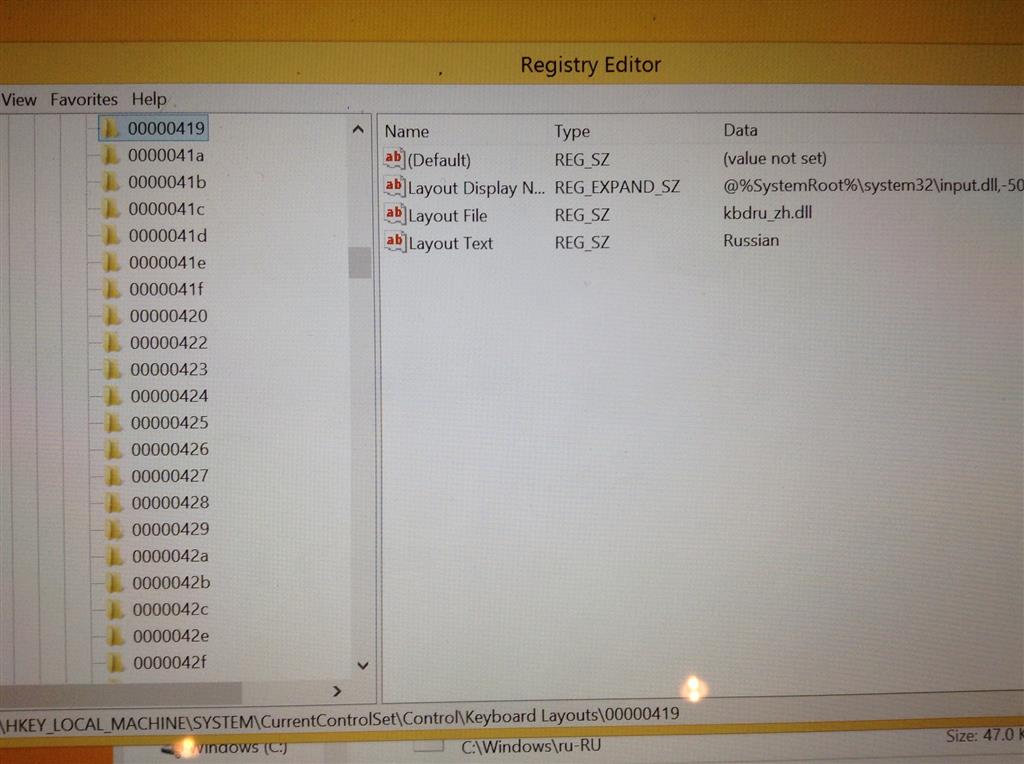

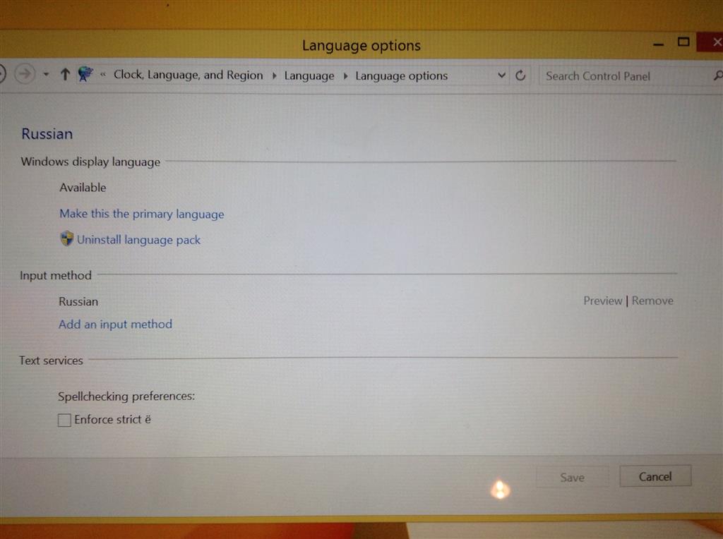

    Thanks, Paul! Sorry for the delay in responding.
    I just tried (1) and (2) in your message, and still no progress. In either case, when I end up with 'Russian' selected, there is no way to switch from English to Russian. (When I tried option 2, I did receive the confirmation that the items were now in the registry.)
    I will try (3) and see if that makes a difference...
    2014-06-06T19:42:53+00:00
    1. I've got an idea (just a guess) why setup.exe did not work for you - please try again but this way:
    • right mouse click and choose 'Run as Administrator'
    I just tried option (3). Unfortunately, when i do this, it gives me the option to run as administrator, but then I get the message, "This app can't run on your PC. To find apps for this PC, open the Windows Store."
    Again, this leads me to think it's a limitation of Windows RT, on the Surface 2, for which it seems that the only 'apps' or 'programs' (or what the Surface treats as apps or programs) that can be installed are those that come from the Windows Store.
