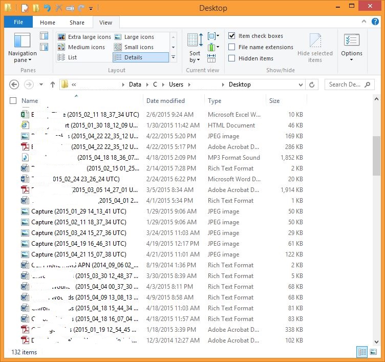

From what I understand you cannot "point" the new Windows 8 machine to use the external drive with previous File History.  You will need to do a manual copy and paste from the external USB (by selecting the appropriate file in the File History directory on the USB drive).
The problem is, File History appends the date and time stamp, thus the file name changes.  For example, MYDOC.DOC become MYDOC.DOC ((2013_04_04 18_27_46 UTC).
How do you remove the parenthesis from the file name when copying the file back to its original location or is File History not a "system restore" type utility.  Whilst the parenthesis will not stop applications working (like WORD, OUTLOOK etc), it looks horrible and creates these long file names that is unwanted.

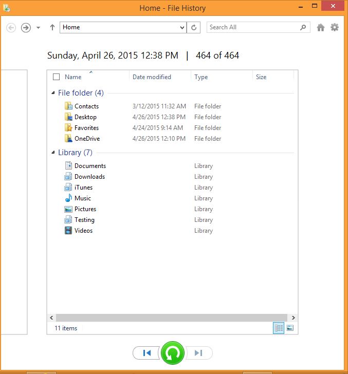

I just had to try to do this, and I was able to (on a new Win8 machine) point at the previous backup by clicking Drives and then selecting my backup drive (a network share in my case). Then I was able to check "I want to use a previous backup on this File History drive" and it displayed my existing backups on that drive. Finally, I was able to do the regular (if not very intuitive) restore files by clicking the settings icon in the upper right of File History.
