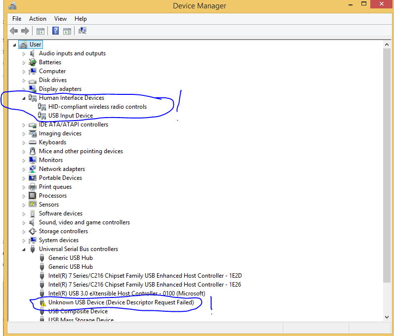

    Dear All,
    I have a problem with my touchscreen. I tired everything expect factory setting because I deleted it before.
    I put the Windows 8, 8.1 but the touch screen has not been working at all. There was a screen keyboard at the bottom of the right hand side. But it`s deleted as well.
    Also, wireless card driver is not working, I I installed the all drivers from Asus webpage. I did all update.
    Any idea ???
    The Laptop is asus s200e-
    MB Version: X202E
    Thanks
