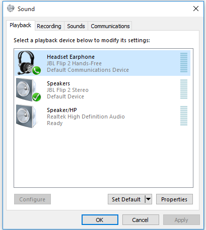

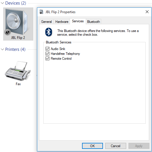

    Today, I tried to connect JBL Flip 2 with my new HP Laptop and the connection and everything else worked fine but still no sound was output on the speaker.
    Initially I thought there would be a simple fix - A driver update but after browsing and check various articles the issue persisted. Then getting clues from various articles, I noticed two things:
    1. In the Device and Printers section, JBL shows two sound services - Audio Sink and Handsfree Telephony.
    1. In the sounds section, following output options are displayed
    On Testing, Headphone earphone was working fine but stereo was not working (which would produce good sound quality).
    Then as a trial, I Unchecked Handsfree Telephony in step 1 screenshot above and then YES you must have guessed right, sounds section showed only one output option for JBL - Speakers and it worked fine, VOILA !!

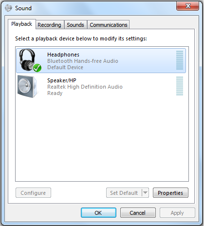

    2016-06-03T07:53:49+00:00
    My case was the sounds initially still using my ThinkPad to output the sounds even I had successfully paired with JBL Clip (basically is JBL Go - but it shown as JBL Clip in Windows 7). Hence I open the control panel -< Sounds -> click the HeadPhone and then press Set as Default. Viola.... now the default speaker output is toward my JBL Go. Hope this can answer your question.
