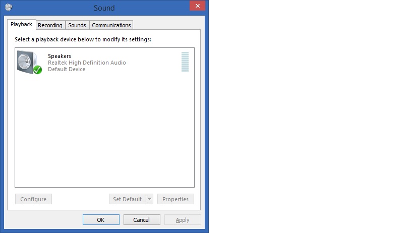

    Now I'm left with only the laptop speakers (as it's a decent ASUS this isn't the end of the world but not ideal). There is no second speaker option in hardware:
    Everything seems up to date from what I can figure out too.

    Several solutions:
    • Change your HDMI cable: damaged HDMI cables can happen and prevent the recognition of other devices. I had once two HDMI cables damaged at the same time, so I had to buy a third one to solve the error but it cost me a lot of nerves because I was sure I had tried "another cable", except it was damaged too.
    • Unhide hidden/deactivated devices
    • In the BIOS try turning on options related to HDMI (not all computers have them)

    just install again your graphic driver again from here : https://downloadcenter.intel.com/default.aspx
    i tried everything but only this one helped me :)
    Which graphic driver? The Intel HD Graphics or my Nvidia GTX 770m?
    I tried to update the driver for the device while pointing windows to the unpacked files NVIDIA created when I first installed my graphic drivers. Windows told me that the Microsoft drivers were the best for that device.
    I also developed this problem after upgrading to Windows 8.1 from Windows 8. Before upgrading, I was able to plug my HDMI cable in to my laptop, and windows would recognize it and automatically switch the audio output to the TV.
    Now, when I plug the cable in, only the video works and the device doesn't even show up in the Playback section under my sound settings. The only workarounds I have discovered that work, are to boot windows with the HDMI cable plugged in, or to uninstall the High Definition Audio Device in the Device Manager, then "scan for hardware changes".
