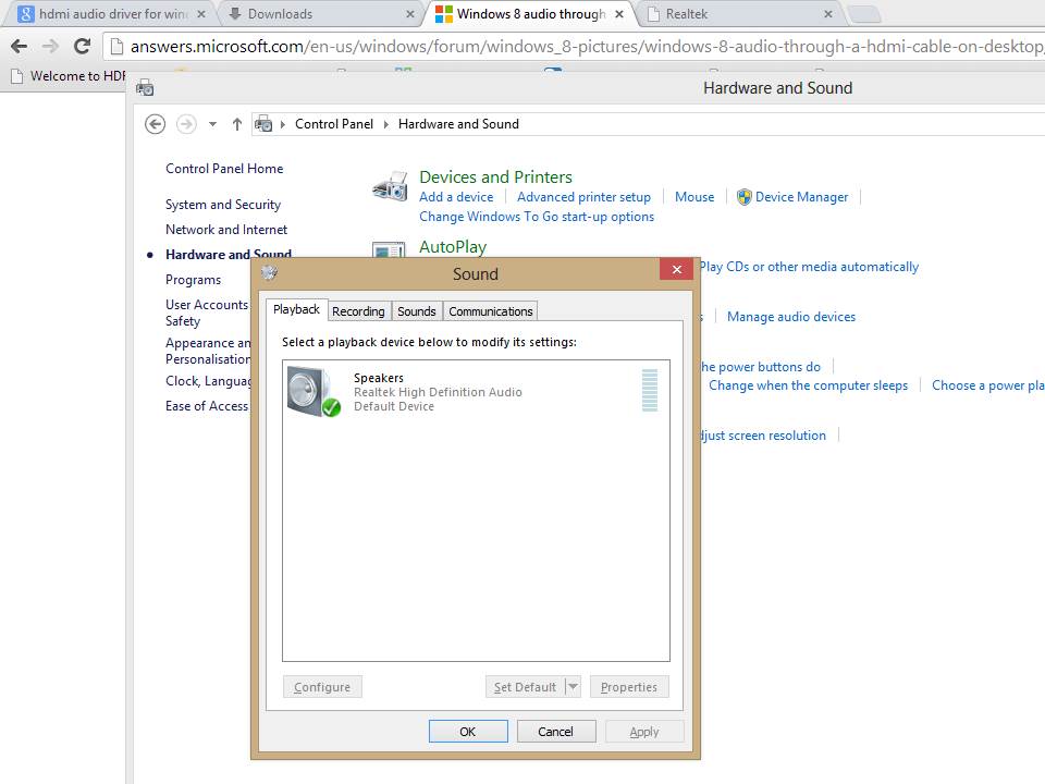

im running windows 8 on a desktop that i have plugged into my t.v. i have the video working fine however my sound isnt coming through and i dont have the start option normally with windows 7 and below so i dont know where to find the control panel. Does anyone know how I can get it set up to run it. I have it going to a Panasonic surround system hooked up to my t.v. all through hdmi cables.

By default Windows does not route sound over the HDMI output. To change this we need to change the settings in control panel.
Note: This will turn off sound from the speakers or normal audio output on the laptop. To get that back you will have to reverse this process.
a) Press Windows key + X
b) Click on "Control Panel"
c) With the Control Panel in "Control Panel Home" view please click on "Hardware and Sound"
d) Where it says "Sound" in green letters there are three options below that are in blue click on "Manage Audio Devices"
e) This will bring up a window labeled "Sound"
f) On the "Playback" tab there is listed the sound options available to you. One should read "Digital Output Device (HDMI)" Click on that.
g) There should now be a check mark on that option, make HDMI sound output as default .
h) The Sound should then play through your HDMI hookups to the TV.

  1. Press Windows Logo Key+X.  Click on Control Panel.
  2. Click on Hardware and Sound.
  3. Double click on Sound.
  4. Under the Playback tab, you should see your HDMI Device.
  5. Right click on it and select Set as Default Device.
  6. Click Ok.
