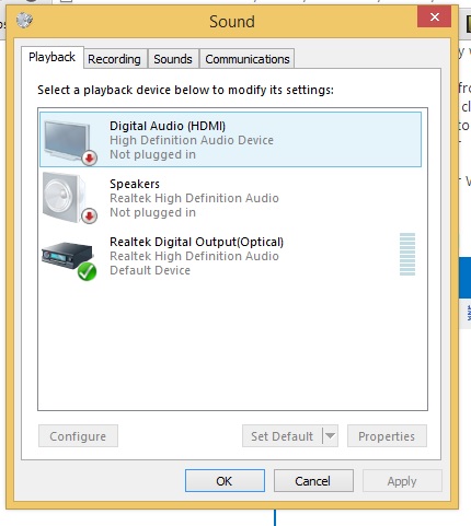

    Hi, in my win 8.1 in Sound -> Playback tab just right click on Speakers and from context menu check Show Disable Devices and Show Disconnected Devices then TV icon should appear. Right click and choose Set as Default Device  :)

    Go into Device Manager
    Expand Sound, Video, and Game controllers
    Right click on High Definition Audio Device
    Select DISABLE
    Right click on High Definition Audio Device again
    Select Enable
    It should now be working. If not:
    Go back to your Sound Properties
    Under the playback tab, you should see your HDMI Device
    Right click on it and select Set as Default Device.
    Both your video AND sound should work now.
