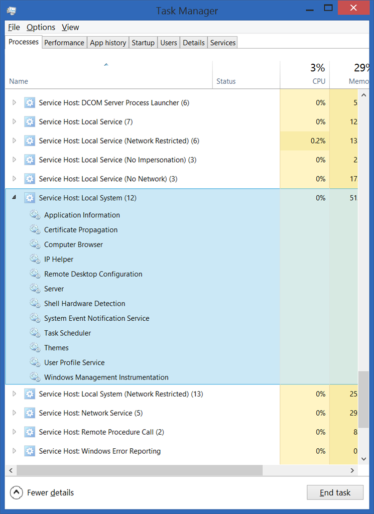

A process called Service Host: Local System is using up all of my laptops resources
2012-12-04T00:03:08+00:00
My laptop has been running very slowly for the past few days which is weird because my laptop is quite powerful and has always run very fast. I looked at my task manager and saw that a process called Service Host: Local System was using up almost all of my RAM. I am running Windows 8 Pro on a Sony VAIO S13P. What can I do to fix this problem?

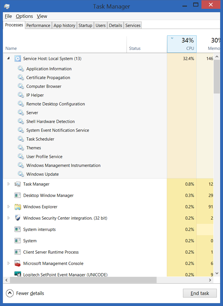

    A couple things I didn't see in any of the responses so far (although I didn't read all of them) which you might want to check:
    • Is Windows downloading any updates? Go to Settings area and check to see if it's in progress downloading the updates it does periodically (this was happening for me--had to install three updates that were downloading)
    • Did it download an update and it wants to install it? Reboot and you'll know if this is the case. (And it's always a good idea to reboot anyway, especially if you're experiencing abnormal activity on a PC.
    • Do you have any cloud storage services like Dropbox or Google Drive which are sync'ing? Check their status in the system tray (bottom right corner where all the little icons are). After I did my Windows updates, I had to pause Dropbox, which was downloading a lot of files I had added through my work PC the previous day). Between this and my Windows updates being up to date, my drive usage became normal again.
    • Are any of your security programs (anti-virus or other similar services) performing scans in the background? This can also be seen in the system tray.
    If you're checking something in the system tray to see if it's running a service, you can often just mouse over it and it will tell you what it's doing.
    Also, you can often pause these for a while and then check your Task Manager to see if that freed up your harddrive. Allow 2-3 minutes for the service to gracefully pause.
    I'm on a Windows 10 machine and it's a desktop, but the above things would apply to any PC.

    YES!!!
    You must open services.msc and disable the following:
    background intelligence transfer service (BITS)
    Windows update
    update orchestrator
