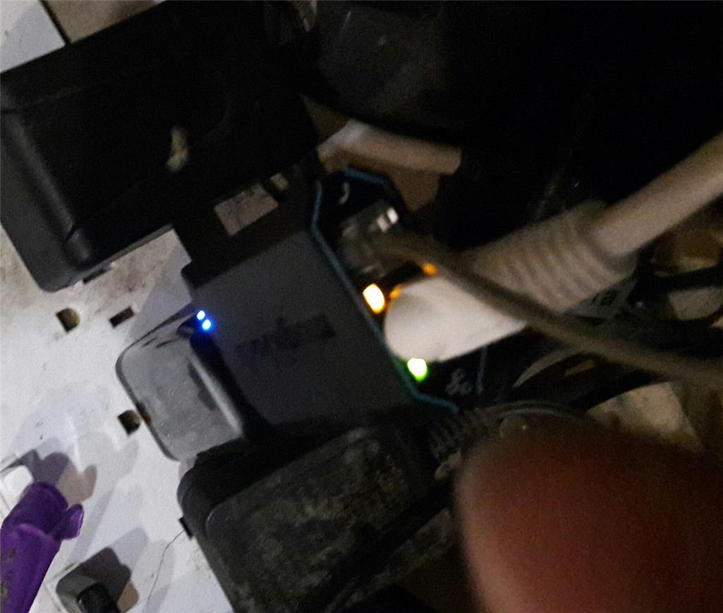

    I noticed after hearing this constant error message that the plug was too wiggly on the outlet. Once stabilized, You should see a green light near your Ethernet cord and a yellow light near your phone cord. Both should be lit. I also changed the flat cord for a more sturdier Ethernet cord and now all is well.  ![](https://learn-attachment.microsoft.com/api/attachments/bc22a5a6-29bc-4f61-91cb-c16c4a9cdb92?platform=QnA)
