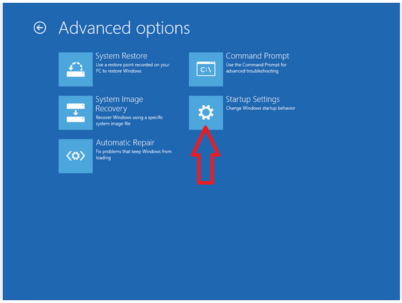

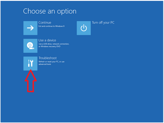

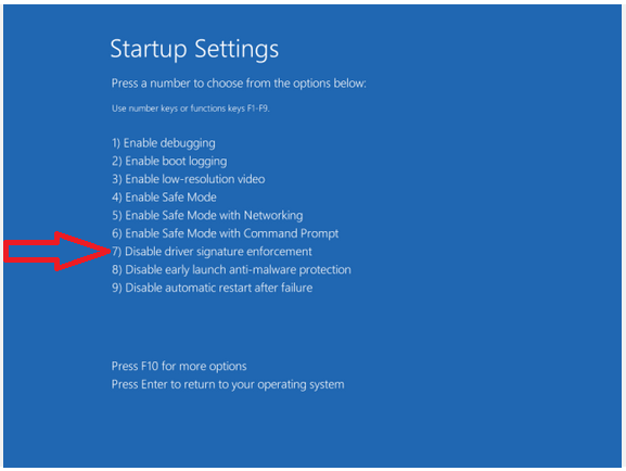

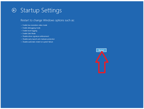

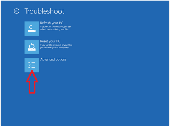

    I might have found a solution that is different from all the others. With this solution you will be able to enter your Homescreen without losing files, but you won't fix the problem for long term.
    Try this.
    1. Open 'Advanced Startup Options'.
    2. Choose 'Troubleshoot'.
    1. Then 'Advanced options'.
    1. Choose Startup Settings
    1. Now restart your PC.
    1. Press the 'number 7'. (If 7 isn't working then relaunch the process and try different numbers)
    Few seconds after that you should be able to see your Homescreen.
