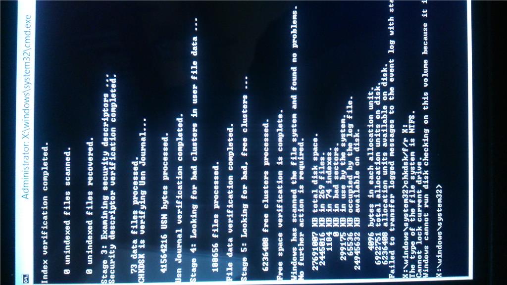

I followed the steps to enter the command in the command prompt. When I do I get the following message:
The drive, the path, or the file name is not valid.
I entered the following in the command prompt:
Chkdsk/f/r X:C
any further ideas?
Actually the command is chkdsk /f /r C:      not X:C

    2016-01-19T22:28:54+00:00
    I'm having the same message. "failed to transfer logged messages to the event log with status 50"
    Have you been able to solve it?
