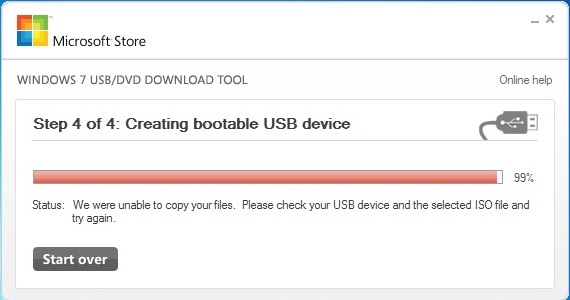

while running Windows 7 USB/DVD Download Tool at step 4 of 4 : creating bootable usb device
Status : we were unable to copy your files. Please check your USB device and the selected ISO file and try again.
why it is not able to copying my windows 7 files into usb device?

Finally i found the solution to my own post and here is the solution for it. I hope it will help some other user who are facing the same problem.
Sometimes if your USB stick has something in its MBR you might get the error
Windows 7 USB/DVD Download Tool error: We were unable to copy your files. Please check your USB device and the selected ISO file and try again.
You have to start command prompt as an Administrator (On Windows 7 that means right clicking the cmd and selecting Run as Administrator) and use the diskpart utility.
WARNING: Be careful to select the right drive or else your day won’t have a happy end because if you select the wrong drive you will lose all your data on this drive!
Instead of formatting the partition with FAT32, you can also use NTFS (like WUDT does), but then you need an extra step to make the drive bootable:
Bootsect.exe /nt60 X:
“X:” is the drive letter of your USB stick. Bootsect.exe can be found on the Windows 7 DVD in the boot folder. However, I can’t really recommend using NTFS. Some USB stick, at least, appeared to be slower with NTFS.
  1. Start command prompt as Administrator and type  diskpart
  2. type  list disk
  3. type select disk  and number of your USB disk ( like select disk 1 )
  4. type  clean
  5. type  create partition primary
  6. type  select partition 1
  7. type  active
  8. type  format quick fs=fat32
  9. type  assign
  10. type exit  to exit the diskpart utility
  11. type exit  to close command prompt
Finally Bootable USB device created successfully.

    2015-08-01T18:30:03+00:00
    sometimes your antivirus can give the same issue, just in case someone else is having the same problem and OP solution doesn't fix the problem :)

    2015-08-26T09:20:26+00:00
    Hi.
    Try to disable temporaly antivirus.
    In my case AVG protects flash drive after erasing the disk.
    After disabling it the Usb Tool works correctly.
