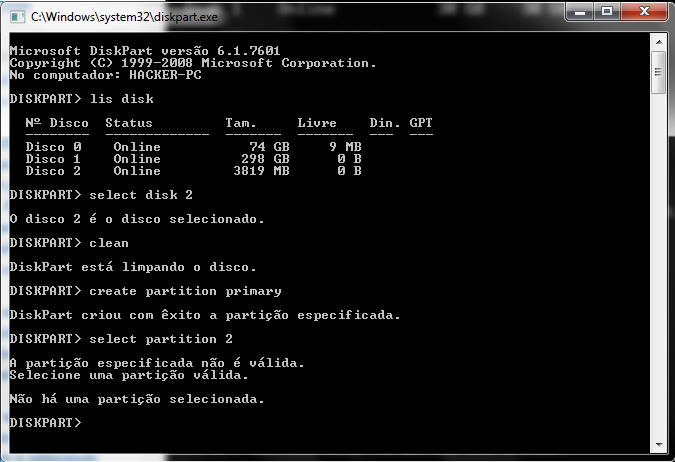

  1. Start command prompt as Administrator and type  diskpart
  2. type  list disk
  3. type select disk  and number of your USB disk ( like select disk 1 )
  4. type  clean
  5. type  create partition primary
  6. type  select partition 1
  7. type  active
  8. type  format quick fs=fat32
  9. type  assign
  10. type exit  to exit the diskpart utility
  11. type exit  to close command prompt
