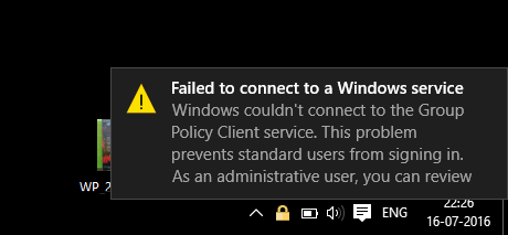

I'm running Windows 8 Professional, and in the last couple of days have experienced random errors trying to login.
Firstly, when I log in as a standard user, I get the message "Group policy client service failed sign in", and cannot login.  If I try to log in as Administrator I can log in but Windows recreates the profile from scratch and when I get to the start menu I have no apps displayed, and cannot find any programs via search.  This problem has happened twice now, and it seems to temporarily fix itself after rebooting, however this morning it took 4 reboots to fix.
I also get the error "Windows couldn't connect to the system event notification service", and again this seems to fix itself after a few reboots.

    2016-07-16T17:45:35+00:00
    i had to switch to the second video since the name of my file at the end was different.
    I have a windows 10 - 64 bit OS.
    In services.msc, the status of my Group Policy Content is blank.
    so i followed the regedit, upto double clicking the variable  "netsvcs" and the window with all the services in my system does not have "GPSVC" as missing. It was present by default.
    still the problem persists..
    Please help.
