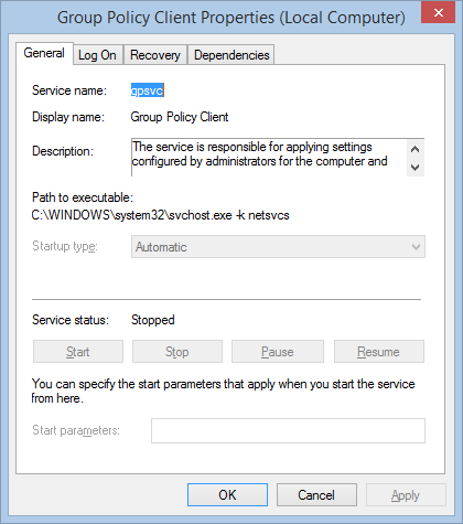

    2014-08-05T11:40:28+00:00
    Dear Ratandeep
    I believe that we are way beyond this point.  The service is not running, and is set on automatic start:
    Thereafter, if we look at the properties, all of the desirable options are greyed out:
    Do you have anything more substantive to add?
    Regards
    Chris
