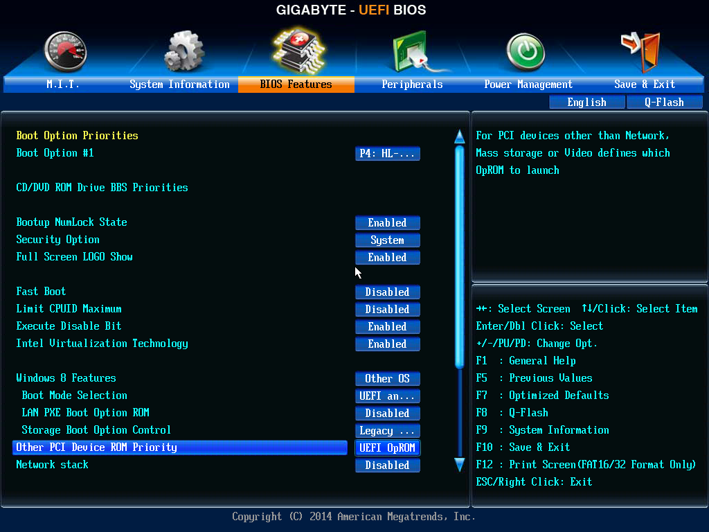

Usually this error message occurs if in the BIOS, booting is set as to start from CD Rom or floppy drive as first boot device. Where as you are trying to boot from the Hard disk.
Go into BIOS  and change the Drive Boot Order so that the Hard Drive comes first as a boot priority. You should be able to boot into Windows normally after you save it to that configuration.
