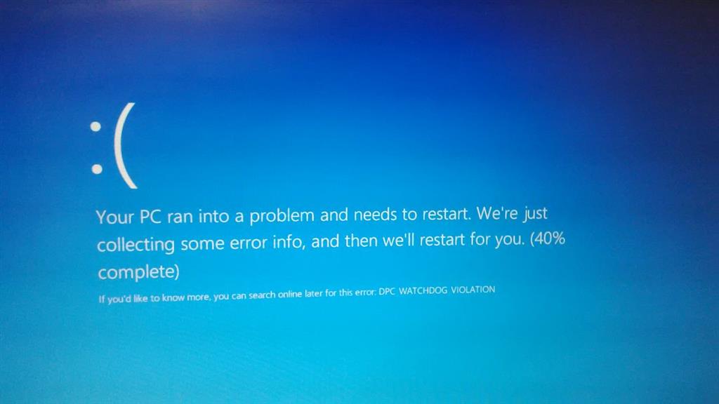

Hello!
Time to time I get the DPC_WATCHDOG_VIOLATION. Moustly when i play games. I use laptop Asus n56vz and SSD OCZ Vector 512 GB . I've tried updating all drivers, BIOS, and SSD Firmware, but i am still getting the error.  I used NOD32 Antivirus i unistalled it but still have this error.
Here is the C:\Windows\Minidump:
https://skydrive.live.com/redir?resid=E828D84DFAA824B6!147&authkey=!ADvi_ktAtwgPGMg
Thank you for your help.

I think the issue can be counted as solved now. No more BSODs after installing NVIDIA driver from laptop vendor ASUS.
Thank you all for help.

    I have started verifier with all drivers. Booting was long, and duering first boot i had BSOD (IRQL_NOT_LESS_OR_EQUAL), after 3 others no BSODs.
    Minidump: https://skydrive.live.com/redir?resid=E828D84DFAA824B6!208&authkey=!ADvi_ktAtwgPGMg
    Also i post info(.NFO  and .txt files) from MSinfo32, maybe this will help - https://skydrive.live.com/redir?resid=E828D84DFAA824B6!209&authkey=!ADvi_ktAtwgPGMg

    The driver that is crashing the system after Daemon tools removal is not in the ones being verified.  You can change the drivers being verified to "all" and it should yield results.

    I had one more BSOD in games. So as you told me i have uninstalled DaemonTools and SPTD. Then i started Verifier again with same settings as before. And i had BSODs during boot again but this time IRQL_NOT_LESS_OR_EQUAL  So i turned off Verifier again in safe mode.
    Minidumps: https://skydrive.live.com/redir?resid=E828D84DFAA824B6!207&authkey=!ADvi_ktAtwgPGMg

    Your call of course but if it was identified by "verifier" there is almost no chance it was something else and it wont go away.
    With BSODS they are always a combination of things so daemon may have worked for a week UNTIL it interacted with something else you may have installed.
    There are other tools that do the same thing and dont crash.  Google SPTD.SYS and see how many you find that exist and sound similar to you situation.
