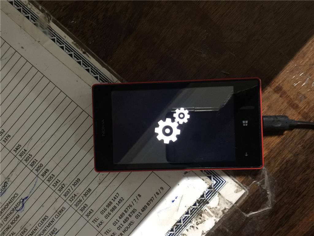

    What am I not doing right because after doing everything you say, it's still not doing what you guys experienced? I want my phone back â˜šī¸đŸ˜”đŸ˜’đŸ˜
    2017-07-07T13:26:04+00:00
    I got this problem too. I tried the said suggestions but ain't working.
    1. Connected to the laptop for device reboot tool.
    2. Used power, volume down and camera buttons.
    they both failed.
    May someone please advise on which option to take?
