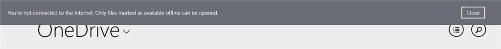

    2014-09-24T09:07:05+00:00
    @WinstonM, I am running into this issue again. It happens intermittently, but after couple of hours elapse OneDrive icon in File Explorer is overlaid by yellow exclamation mark and Modren OneDrive app complain your PC is not connected.
    It seems like, it stops trying to connect after few hours (or days, as I don't restart/shutdown my computer quite often). Restarting the computer fix it.
    File Explorer:
    OneDrive app:
