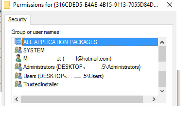

    2016-01-25T23:43:56+00:00
    When you changed the ownership, did you change it to "Administrators"? As in with an 's' at the end?
